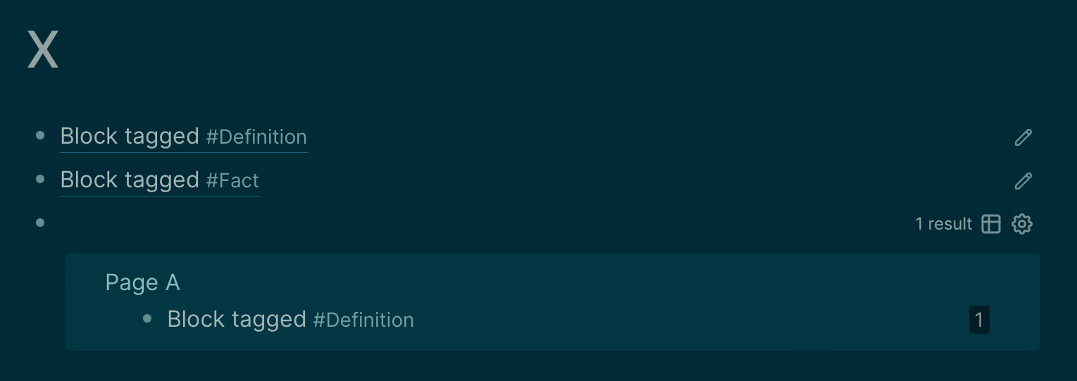

Set up to use with the provided query. Hope this helps with troubleshooting. (Last bullet is query posted, showing the result)
Thanks so much for checking this. The problem was that I wasn’t using all lowercase in the query when referencing the page name.
