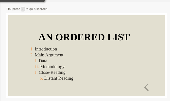

The current state of the Presentation Mode is, unfortunately, quite underwhelming.
However, a large part of it can be fixed by simply adding some custom CSS.
.reveal {
    & .embedded {
    aspect-ratio: 16/9;
    height: auto!important;
    & ol ol {
        list-style-type: upper-roman;
        & ol {
            list-style-type: lower-latin;
The above will:
  • Fix the rendering of the preview window
  • Style the first three levels of nested ordered lists differently.
Before:
After:
