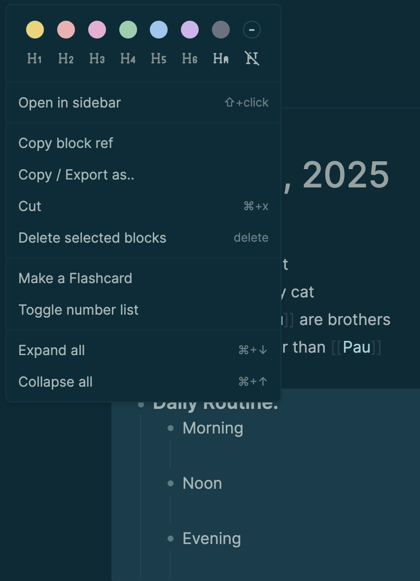

I am trying Logseq DB on a Mac, browser is Chrome. After right click, this is what I got.
I’d like to know if this is a bug, or Logseq DB not compatible with Chrome on Mac.
Thank you

Hi @danzu, I am watching your video above and here is my first question. Hoping that you could help clarifying.
When selecting multiple blocks, the action bar doesn’t appear on top. I do have an account, did log in, and turn on the Dev mode. I am also using Logseq on Chrome on a Mac.
Thank you,
Answering my own question, after selecting the blocks, one needs to hover the mouse pointer above the selected blocks.
