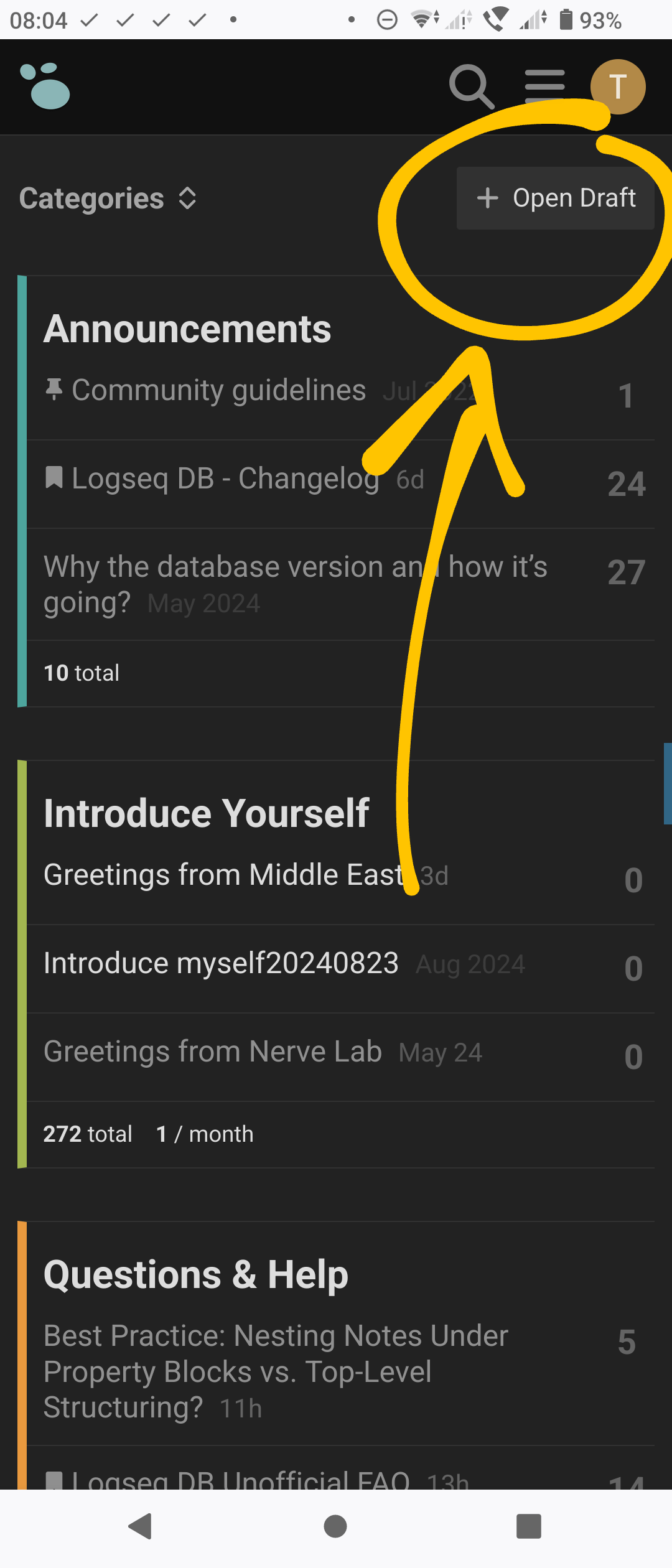

Newbie here. I’m sorry for posting this here, but I cannot find the icon of where I can initiate a new post and I was wondering if you could help me out. I feel like an imbecile asking the question, but I legit can’t find where the icon to create a new post.
I’m on mobile and this is the button I use. PM me if it doesn’t work I’ll see if I can help. Save distracting this thread.
If it works maybe best to delete the comment to keep it tidy.
