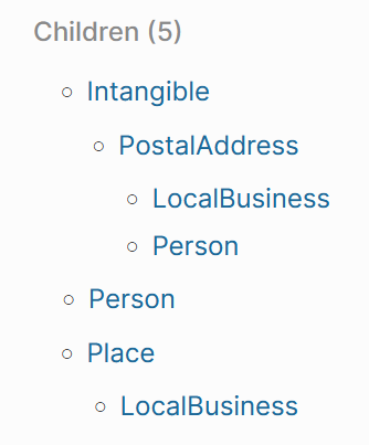

2nd scenario - The tag #Person accepts the extend Thing and Thing/Intangible/PostalAddress
  • Start with a new graph
  • Create tag #Thing
  • Create tag #Intangible
  • Create tag #PostalAddress
  • Set extends field (parent tag) of #PostalAddress to ‘Intangible’
  • Create tag #Place
  • Set extends field (parent tag) of #Place to ‘Thing’
  • Create tag #LocalBusiness
  • Set extends field (parent tag) of #LocalBusiness to ‘Thing/Place’ and ‘Intangible/PostalAddress’
  • Create tag #Person
  • Set extends field (parent tag) of #Person to ‘Thing’ and ‘Intangible/PostalAddress’
  • Set extends field (parent tag) of #Intangible to ‘Thing’
The hierarchy from the tag #Thing is now as the screenshot below. Notice that the tags #LocalBusiness and #Person are mentioned twice in the hierarchy (the desired result).

  2. As for the other point, the difference between the 2 scenarios, is that in actuality I think there shouldnt be a difference between them and you may have encountered a bug lol. The reason why in the first scenario you cant extend Person with both Thing and PostalAdress is because PostalAdress extends Intangible which extends Thing, so its kind of redundant. Going back to the previous example with Books, lets say now I want to create a new tag only for #ScienceFictionBook s, and I would extend it with #LiteratureBook. Then, it would serve no purpose to try and extend it with #Book, because its already a Book since all Literature books are Books
