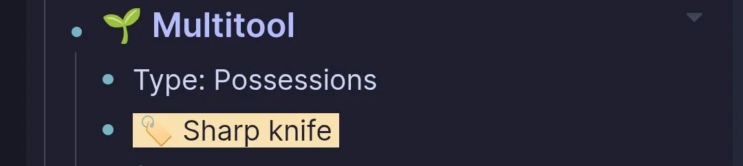

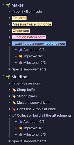

Highlighting words and phrases is very useful in this game. I’m trying to add an emoji at the start of a block and then highlight the rest of the block in different colors (yellow, red, green, etc).
In the example bellow I set the whole block to be highlighted in yellow, but that also highlights the emoji and it makes the whole thing hard to read. Is it possible to detect if there’s a specific emoji at the beginning of the block and then highlight just the test part?
Here’s more or less what it looks like for half of the character sheet:
