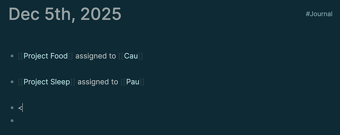

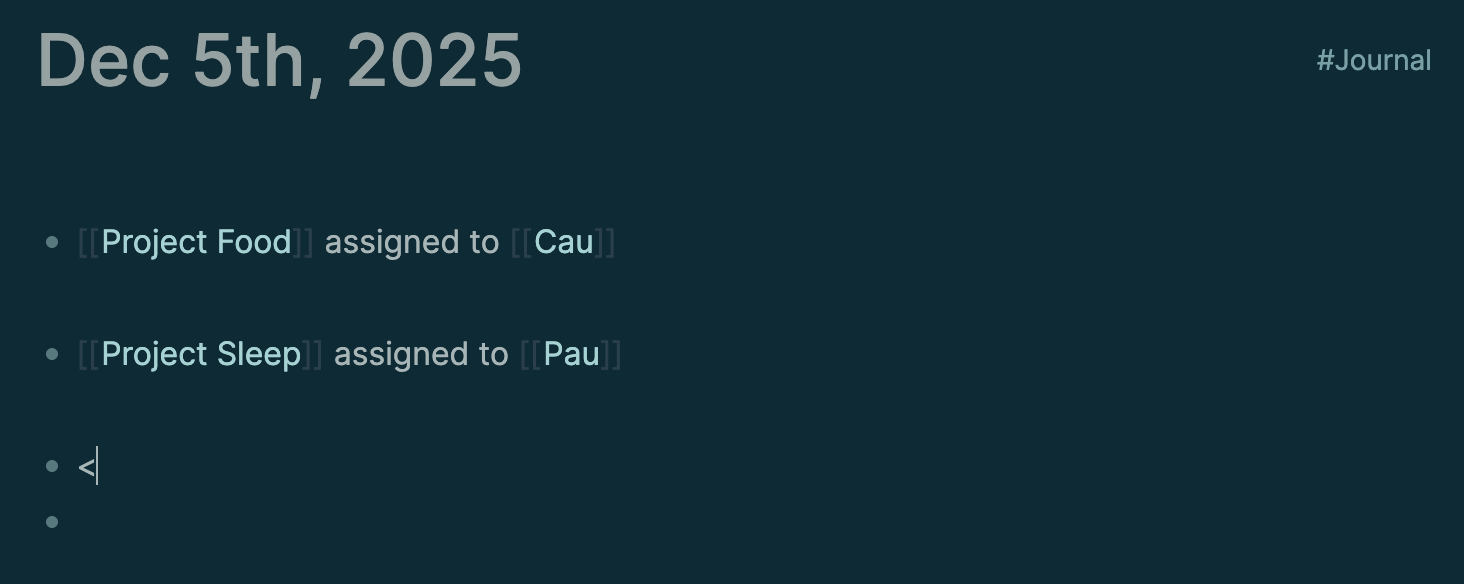

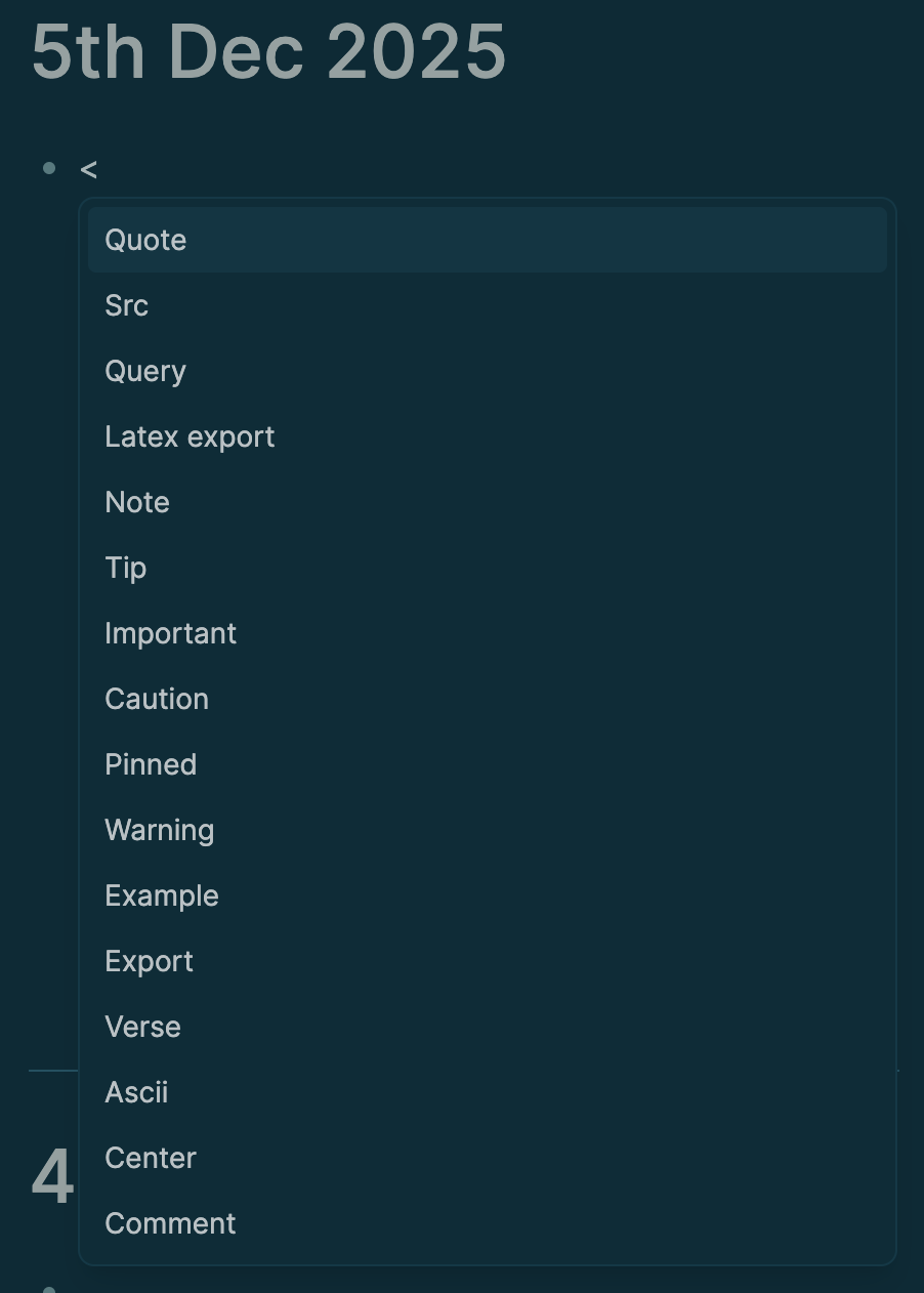

After resisting for months, I am now trying Logseq DB and struggling to find way to add Admontions. In Logseq MD, it’s conveniently accessible by just simply type < and I can get a list of all admonitions.
However, it’s not the same with Logseq DB.

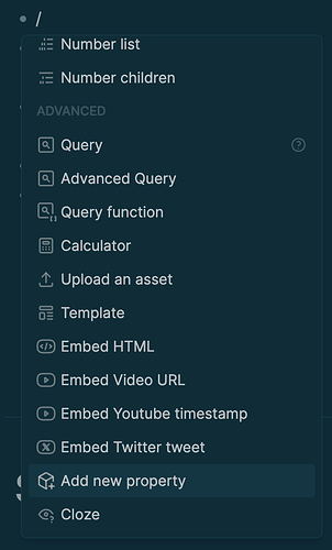

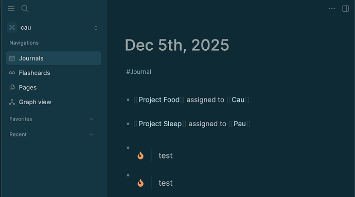

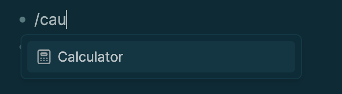

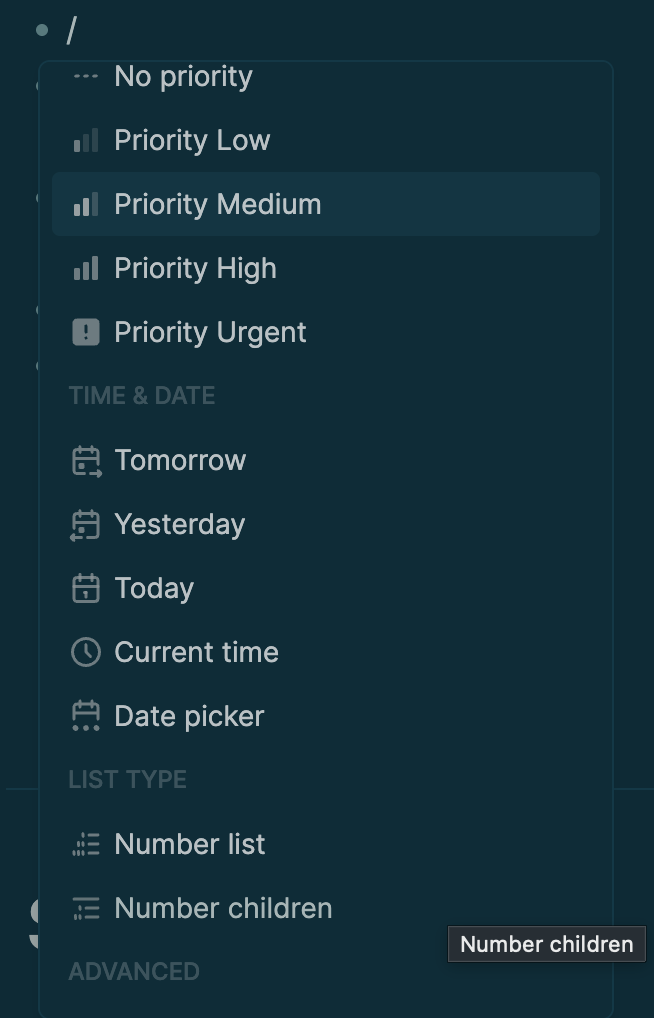

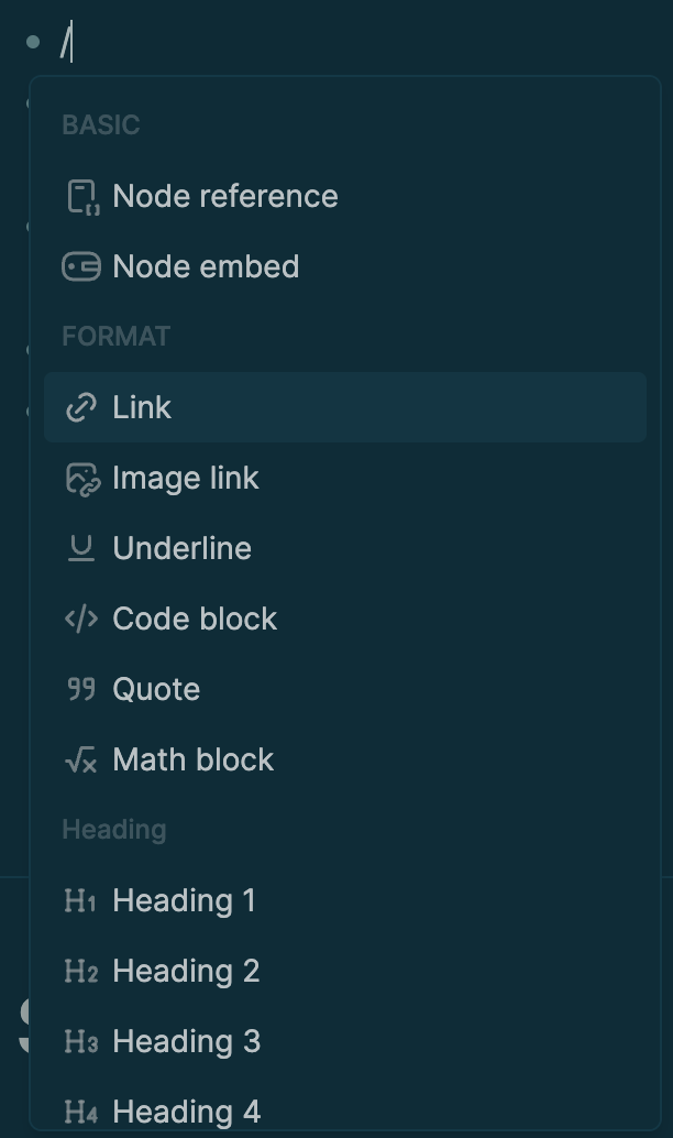

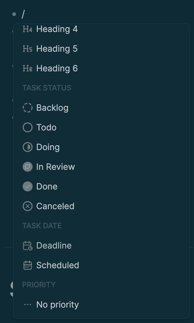

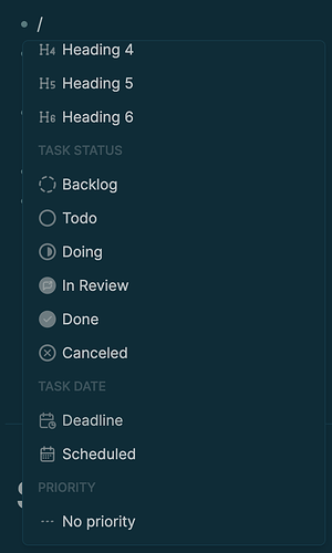

I tried / and went through all the commands but admonitions are not found in the list.
Tried /cau and hoped for caution but only Calculator pops up.
Here are the screenshots.

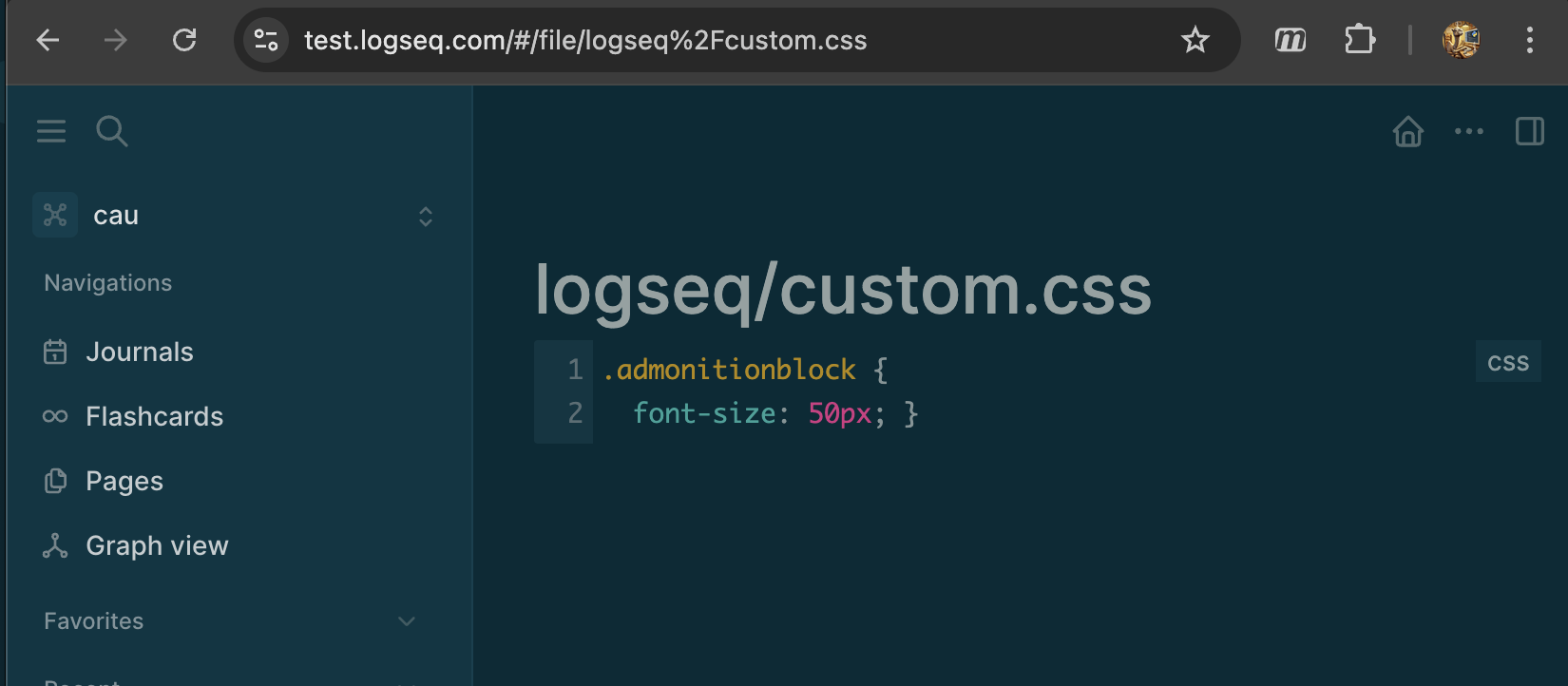

By the way, I tried both .admonition and .admonitionblock, none of them works. I set font size to a crazy value of 50px, just to see if it makes any difference.
Admonitions are not available through slash commands and tag at the moment except for Quote.
