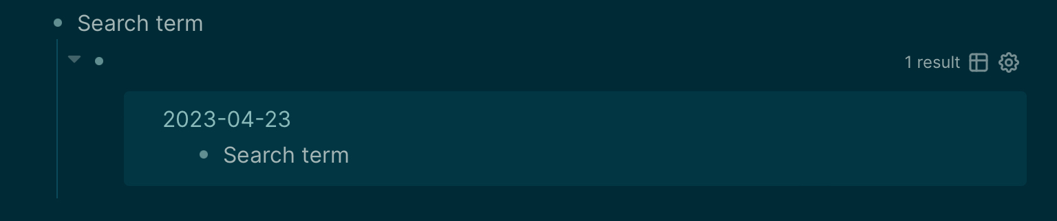

The results are all in duplicate: why is that? I thought it was only a quirk of the simple query {{query "search term"}}, so I used the above, but it still happens.

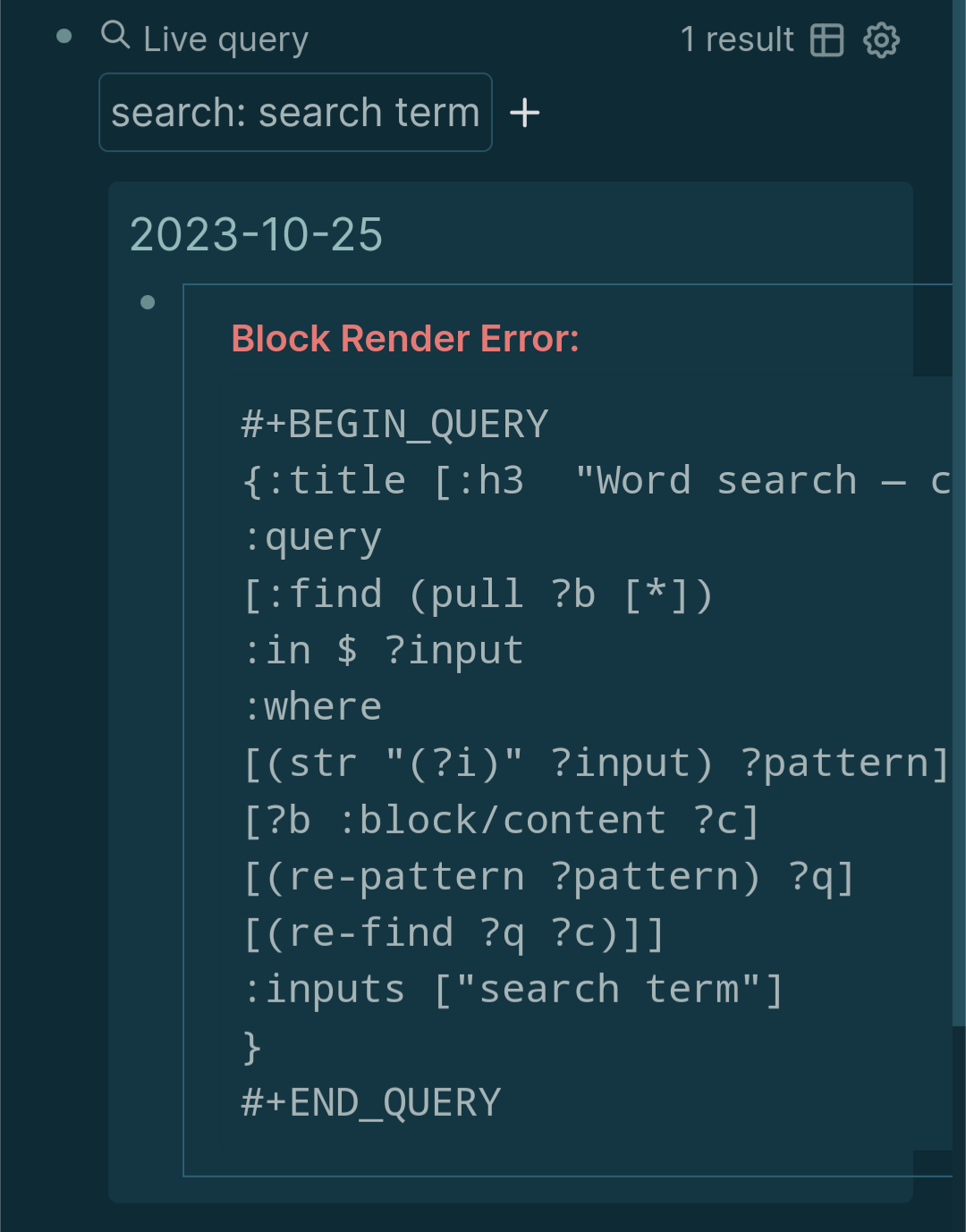

Same here. No duplicates. (Yes I have search term in my test graph lol)
Though this result is quite interesting :joy:

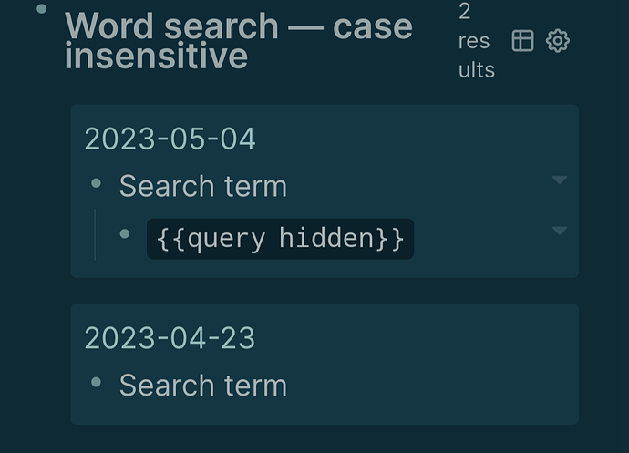

I had the {{query hidden}} too, though I did not put it there so I deleted it, not that it changed anything. I do not get the “Block Renderer Error”.

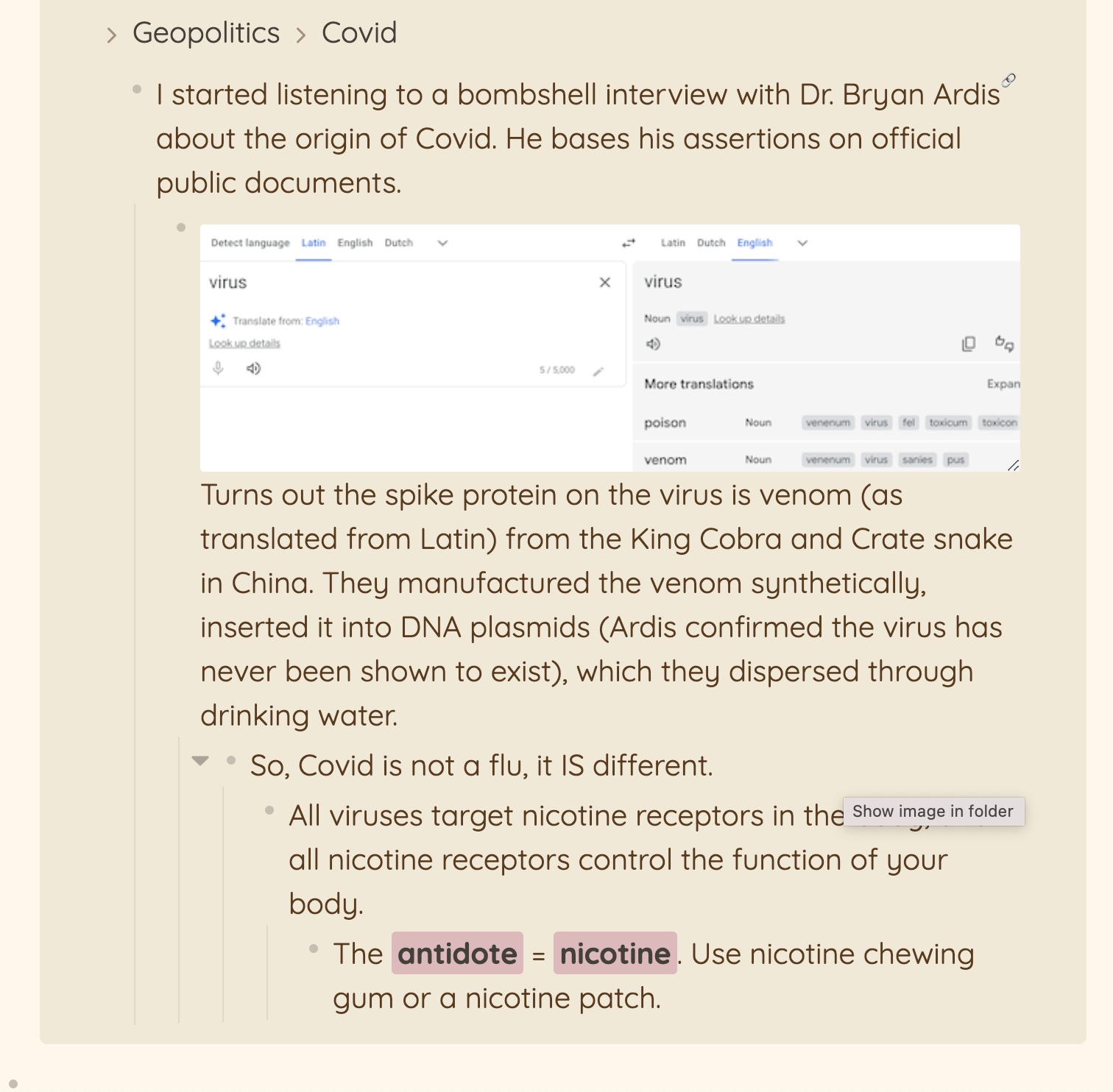

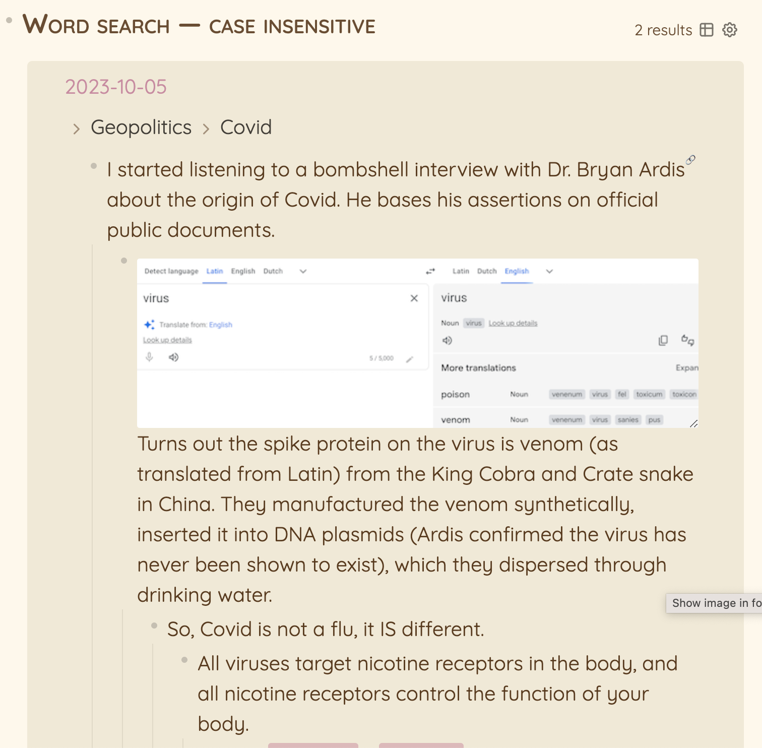

As an example, I have made a screenshot of a page that gives duplicate search results. Here is the original page, which is a journal page:
The search term is ardis, which occurs in the Covid section:

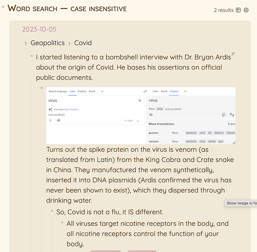

So, my question is: do you see anything odd in the way I have put the text in the journal page (1st screenshot) that might give the duplicate result (2nd screenshot)?
  • I don’t see anything suspicious.
  • I cannot reproduce the double result.
  • Remove those blocks and try re-adding their content gradually, while observing the query’s behavior.
I removed the block, which only occurs on the 2023-10-05 page. However, the search result dropped 1 “copy” of the ardis block, but still shows 1 copy, even though there is no ardis text on the 2023-10-05 journal page!

:astonished: don’t do that! The query hidden shows up to say that block contains a query that has been hidden. (So we don’t render queries in an endless cycle)
It is what @mentaloid says.

It does not show up in the renewed Word search query, nor does it show up in any of the other queries I have always open.
So, when/from where is the hidden query syntax added?
It just means the block in the query result is itself a query. And instead of rendering the query it says it has hidden it.
In my example the block that shows that looks like this:
As you can see it had hidden the query in the block.
But why does Logseq do that? What is the advantage?
Performance and preventing getting caught in an endless loop. For example if a query has itself as its result.
