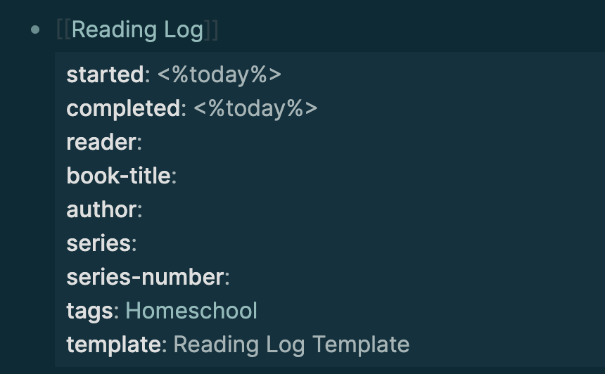

I have a template defined for a [[Reading Log]].
As my kids finish reading books, I add Reading Log entries to the daily journal. They end up reading the same books, sometimes more than once, which means that I end up entering the same book-related information repeatedly. The relational database part of my brain doesn’t like that.

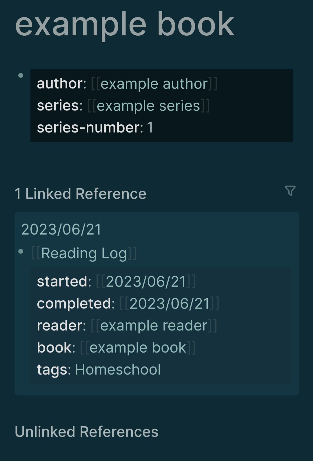

How can I reduce the data duplication? It seems like I could make a page for each book they read, and make page properties for author, title, etc. The difficulty comes when I want to combine that information with information from the Reading Log in a query result table. I haven’t been able to get a query to return information from more than one block type.
tl;dr: How do I reduce data duplication in block properties. Can I retrieve properties from child blocks and combine them with parent block properties?

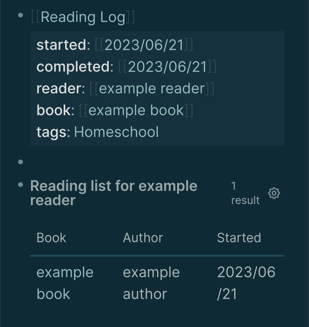

I made you an example.
Query:
{:title [:h4 "Reading list for example reader"]
 :query [:find ?n ?author ?started
  :keys book author started
   [?b :block/properties ?prop]
   [(get ?prop :started) ?started]
   [(get ?prop :book) ?bk]
   [?p :block/original-name ?n]
   [(contains? ?bk ?n)]
   [?p :block/properties ?pageprop]
   [(get ?pageprop :author) ?author]
   [?r :block/name "example reader"]
   [?l :block/name "reading log"]
   [?b :block/refs ?r]
   [?b :block/refs ?l]
 :result-transform (fn [result] (sort-by (fn [r] (get-in r [:started])) > result) )
 :view (fn [rows] [:table [:thead [:tr
    [:th "Book"] [:th "Author"] [:th "Started"] ] ]
 [:tbody (for [r rows] [:tr
    [:td [:a {:href (str "#/page/" (get-in r [:book]) )} (get-in r [:book])] ]
    [:td (get-in r [:author]) ]
    [:td (get-in r [:started]) ]
If you want any details of how things work, I’m happy to explain.

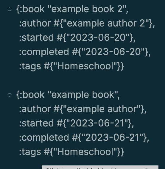

I’ve been playing with the solution you provided and I think I understand how much of it works. I’m not certain that I want to use a view to produce a table, though. I’m interested in using the Logseq query tables so that dynamic sorting is an option.
When I comment out the view logic, I get back a list of maps.
Is there a way to load those maps into a Logseq query table? I’m guessing that the pull method is involved in that, but I’m still not sure how to get data from a parent and child block into the result table when using pull.
Here’s what I’m using to generate those maps:

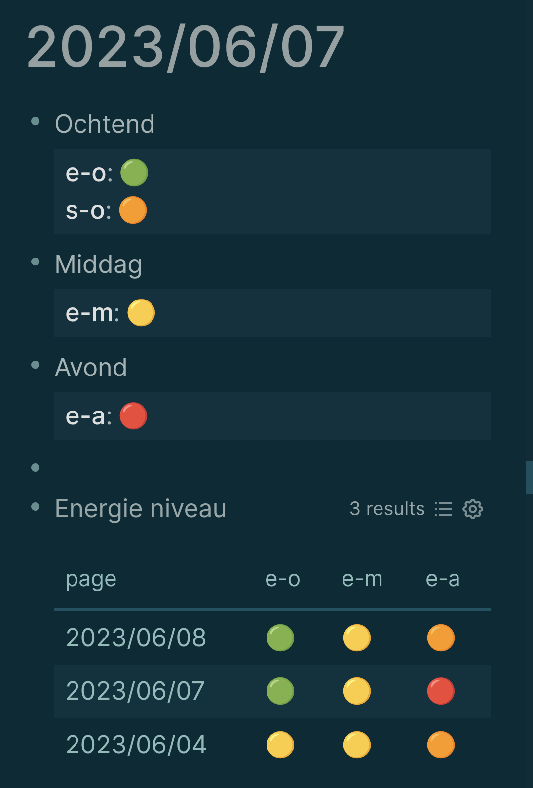

So there is a very complicated :result-transform that honestly I don’t understand.
It merges different blocks together.
Here’s an example of what it does:
The three seperate blocks shown at the top are combined to one row in the query result below it.
This query uses :find (pull ?b[*]) and the :result-transform I included below.
I don’t know if it can be modified to do something with :find (pull ?b [*]) (pull ?p [*]).
But I think that’s the direction for your solution.
