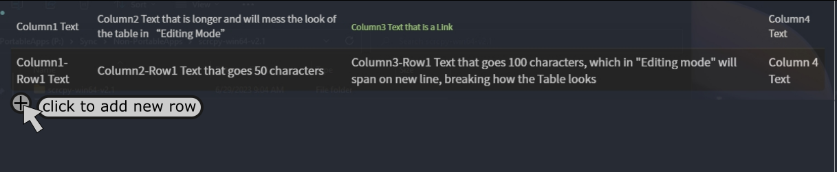

I wish it was possible to work with tables like we do now with list checkboxes, which can be “edited” -checked- without going into editing mode and placing an “x” inside the square brackets. Just like checkboxes, the table cells could be rendered as text fields by Logseq and Logseq could also have a “Add new Row” clickable button just like the “+” circle that appears so you can add a new bullet. It could take the “template” of he new row from the dashed row just under the header for this, and removing the dashes in the process:

(+) (<- “Add New Row” button that gets replaced, upon click, to “| | | |” in Markdown and displayed in Non-Editing Mode, with editable fields, just like checkboxes do);

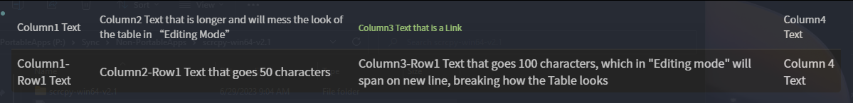

  1. How the table looks in “Rendered-Mode”:

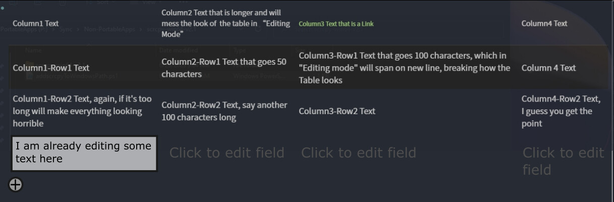

  4. How would I like to do Table Editing in Logseq:
