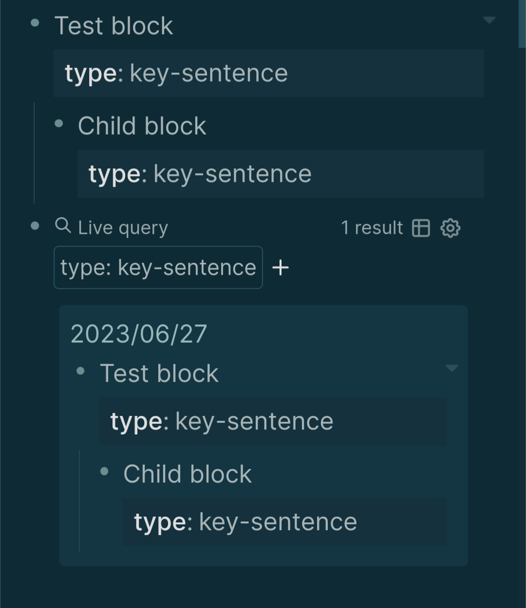

Can you provide screenshot of the issue?
Here is what I see.
So the issue is that child blocks are not shown in the table view and also filtered from the result because of a default option.
