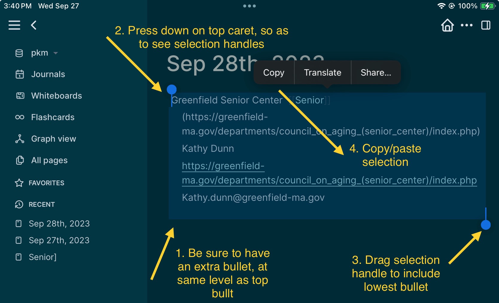

See my image, and follow according to numbers
Yes, this solution is better than mine, which I posted below, because I was having a hard time swiping, then copying.
But then I discovered that when I collapse then expand the top bullet the swiping and copying part is much easier, plus the paste in the text editor works much better.
