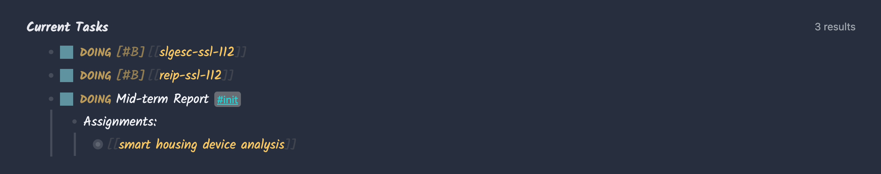

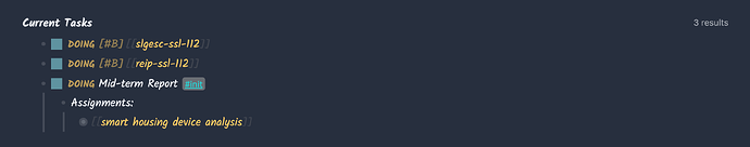

I have made a default query to show all doing jobs that works fine. However, is it possible to show page name instead of the TODO block. So that I can directly link to the page while clicking on it. (i.e. the following image Mid-term Report is quite vague since I don’t know the project it belongs too, and I have no direct link to it.)
This is the query I used and the result:

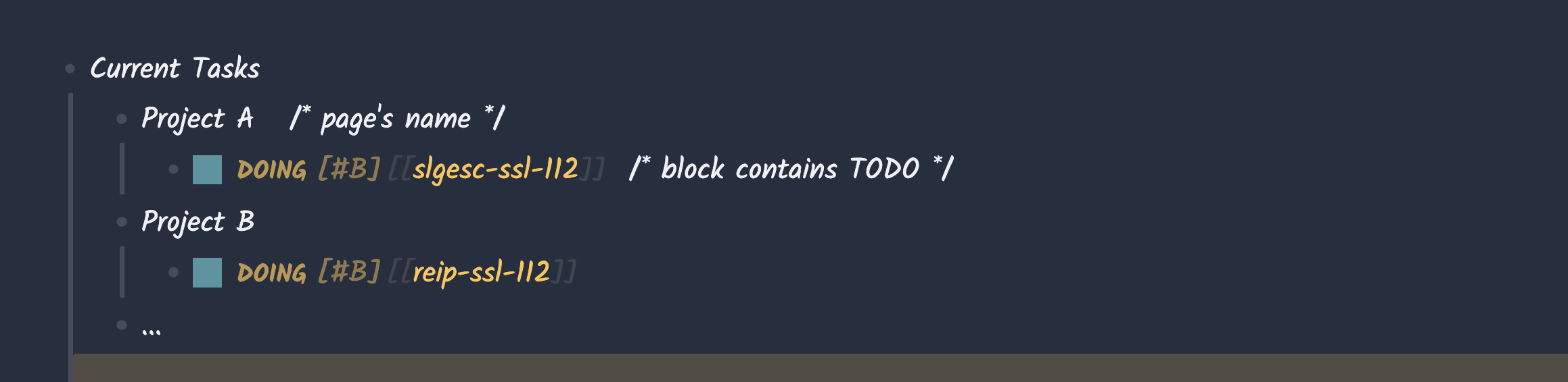

And this is what I would like to achieve (table view is fine too), and the ability to link to the page by pressing Project A block.

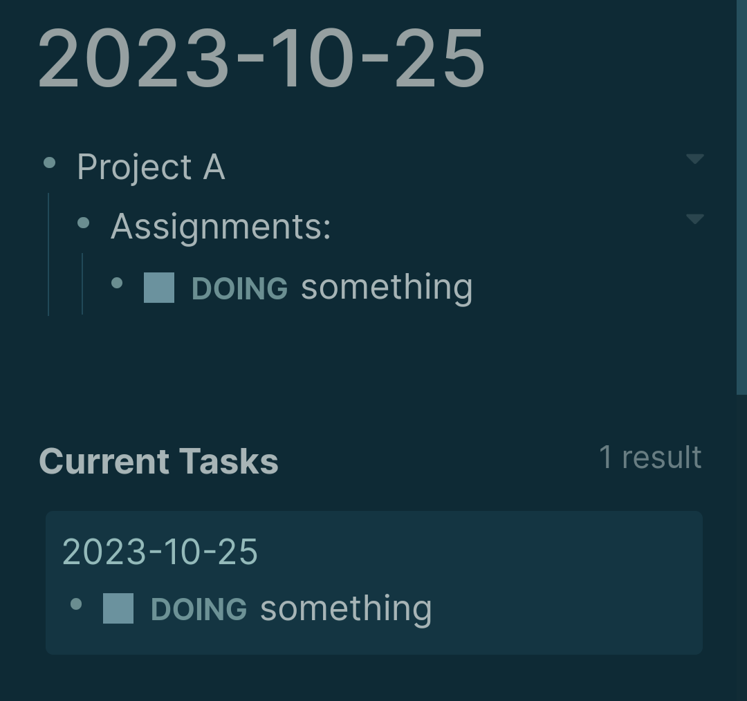

To your reply, when removing breadcrumb-show, using the example above.
The output for multilevel blocks (see Mid-term Report block) would also show.
The following demonstration might explain clearer

Just removing the result-transform line gives.
Aka this query.
