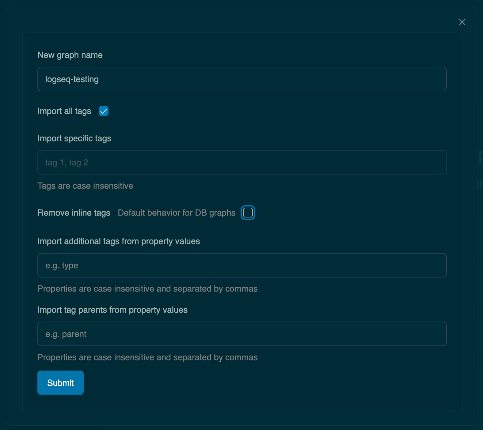

As a test, I imported my graph into test.logseq.com and generally things are working quite well. The only thing I noticed is that, even when I uncheck ‘Remove inline tags’

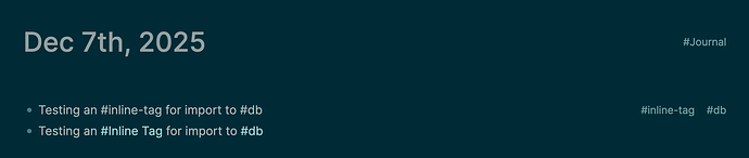

I end up with end of line tags unless they were surrounded by double brackets. For example, a test graph with:
- Testing an #inline-tag for import to #db
- Testing an #[[Inline Tag]] for import to #[[DB]]
Results in:
Is there a way to preserve the inline tags that exist without the brackets?

The end-of-the-line position for tags is the default behavior
Thank you, my question was more though, is there a reason why a line like:
- Test of an #inline-tag for import to #db
Doesn’t import those as inline tags but does if they are wrapped in brackets?
