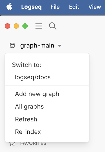

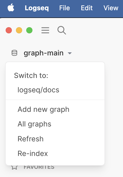

I don’t have the “New Window” in that dropdown.
Also, there is: in the OS toolbar → File → New Window. But this doesn’t do anything when I click it.
I’m on macOS
The drop-down menu should be something like:
Switch to:
graph1 name
graph2 name
Add new graph
Re-index
New window
New windows may note be suitable for hoegge’s usecase, he want to do some rewriting while the same page is opened in two windows. According to my own experience, if I open two logseq windows with same graph and write something in one window, while the same page is opened in the other window, it will pop up a window indicating that there is conflict.
