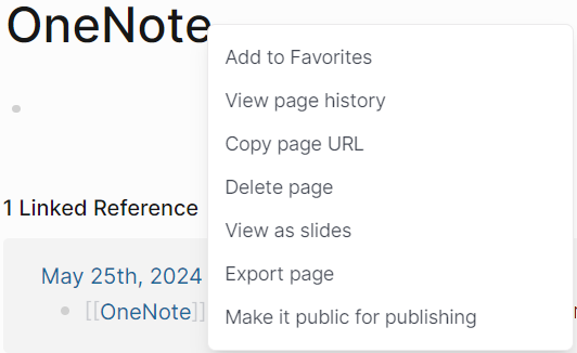

Missing Pages 1
With these pages, that command doesn’t exist. I have to copy the page URL, which in-turn creates (reveals? probably re-creating) the page in the folder after I’ve pasted it. Only after this has happened do I see the command to Open in Directory by right-clicking on the page title, or using the drop-down menu on the top right like you pointed to.
I went from 21 pages from yesterday, to 25 today while putzing with this.
