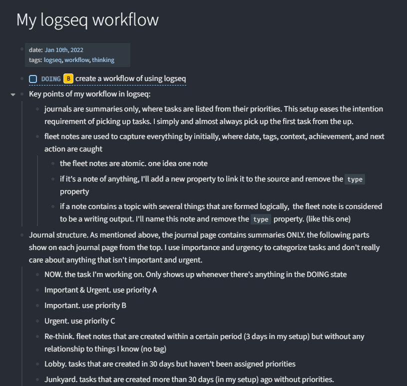

Key points of my workflow in logseq:
- journals are summaries only, where tasks are listed from their priorities. This setup eases the intention requirement of picking up tasks. I simply and almost always pick up the first task from the up.
- fleet notes are used to capture everything initially where date, tags, context, achievement, and next action are caught
- the fleet notes are atomic. one idea one note
- if it’s a note of anything, I’ll add a new property to link it to the source and remove the
type
property - if a note contains a topic with several things that are formed logically, the fleet note is considered to be a writing output. I’ll name this note and remove the
type
property. (like this one)
Journal structure. As mentioned above, the journal page contains summaries ONLY. the following parts show on each journal page from the top. I use importance and urgency to categorize tasks and don’t really care about anything that isn’t important and urgent.
- NOW. the task I’m working on. Only shows up whenever there’s anything in the DOING state
- Important & Urgent. use priority A
- Important. use priority B
- Urgent. use priority C
- Re-think. fleet notes that are created within a certain period (3 days in my setup) but without any relationship to things I know (no tag)
- Lobby. tasks that are created in 30 days but haven’t been assigned priorities
- Junkyard. tasks that are created more than 30 days (in my setup) ago without priorities.
