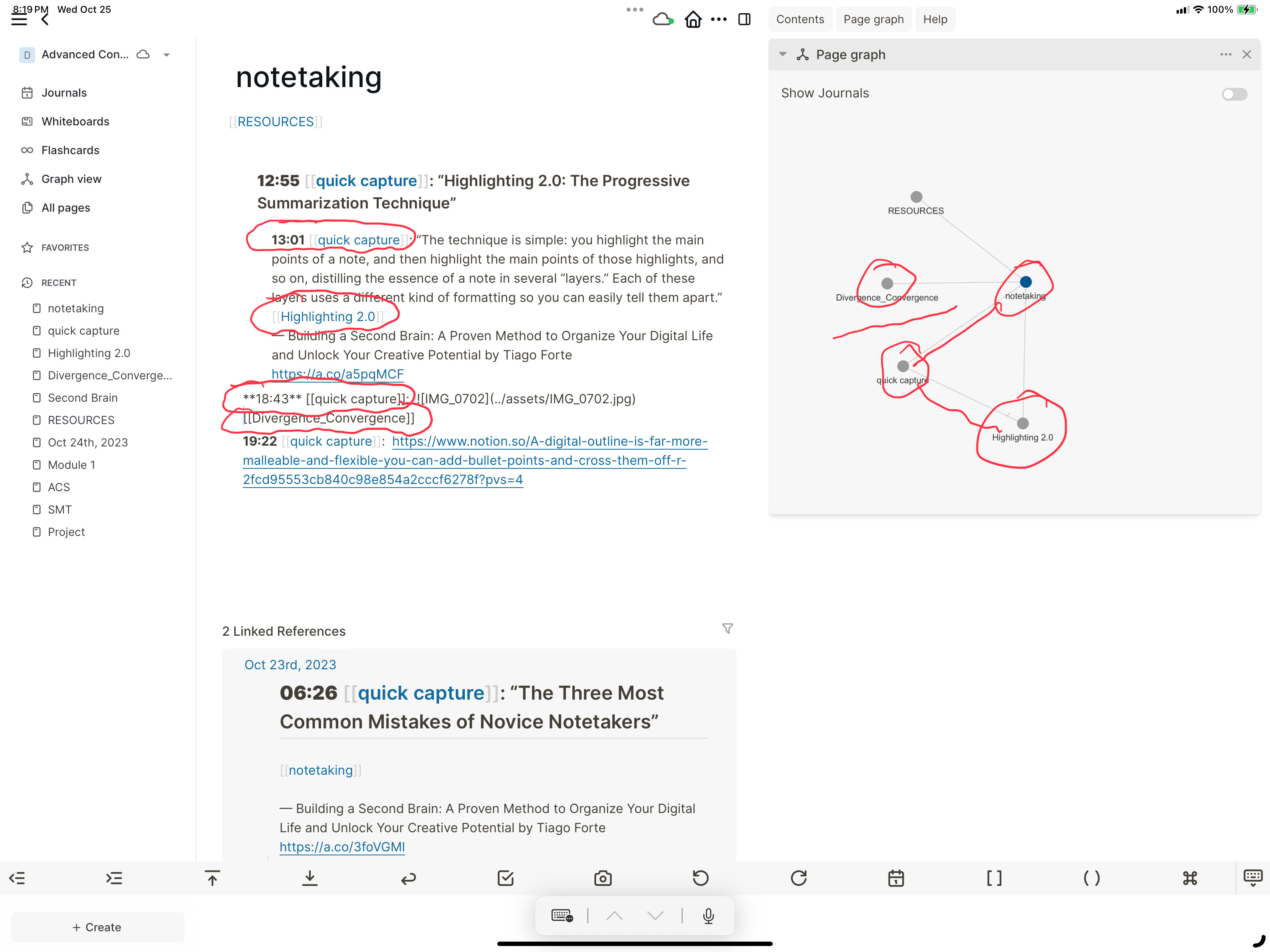

Please view the attached image. I don’t understand why the quick capture page has a connection to Highlight 2 but Divergence_Convergence does not have a connection to quick capture. I’m new to this and appreciate any guidance you can give me. If the answer was in your last reply I’m sorry that I didn’t understand it.

notetaking) have nothing to do with whether third pages connect to each other or not.Holy moly I feel stupid. I apologize that I’m having difficulty interpreting your last response.
Is it possible for you to give me an actual syntax example I can plug into my pages to recreate what you’re trying to explain to me so I can duplicate it on my end and learn from your example?

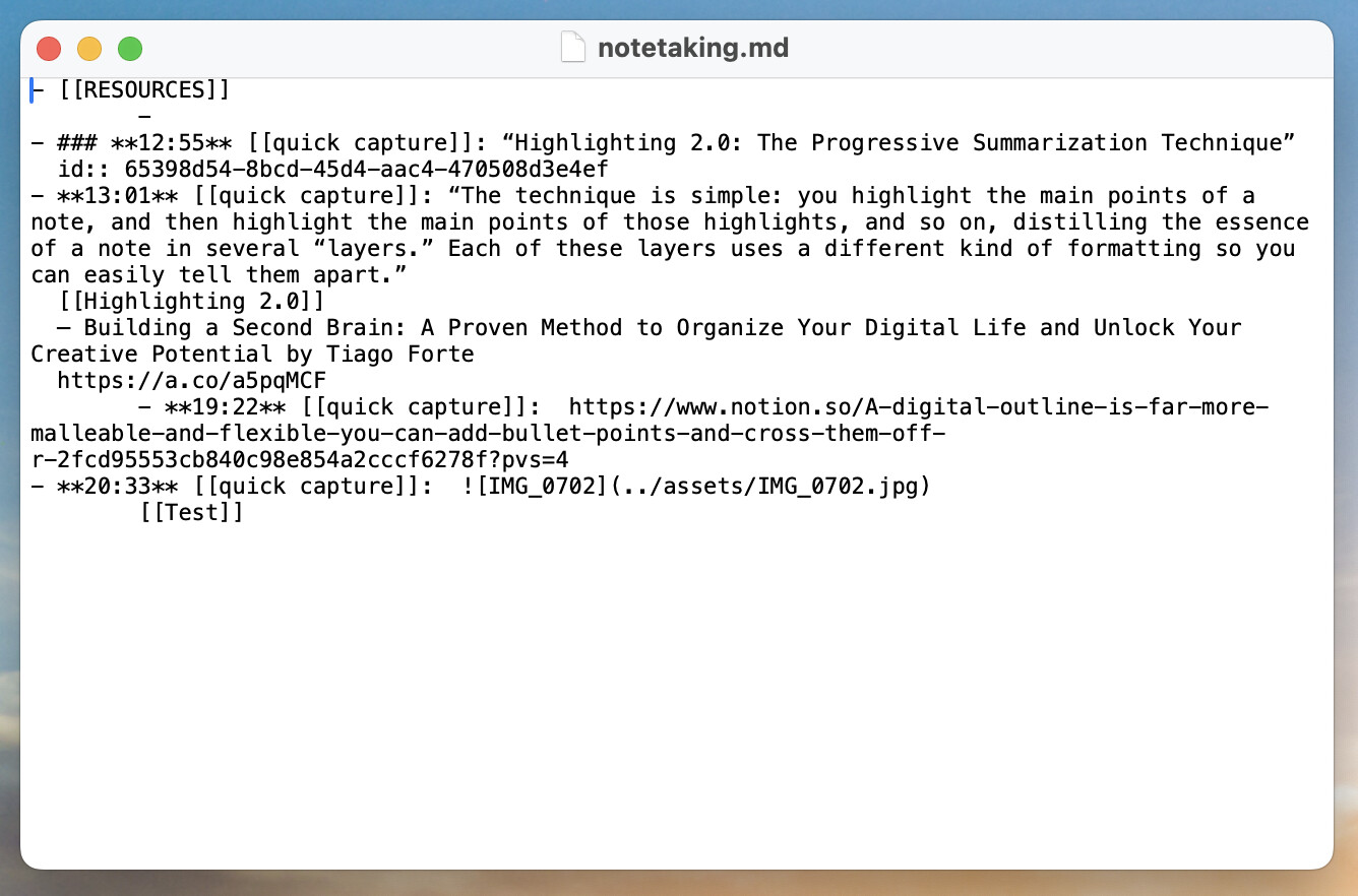

As you requested here are the screenshots of my markdown file and the page.

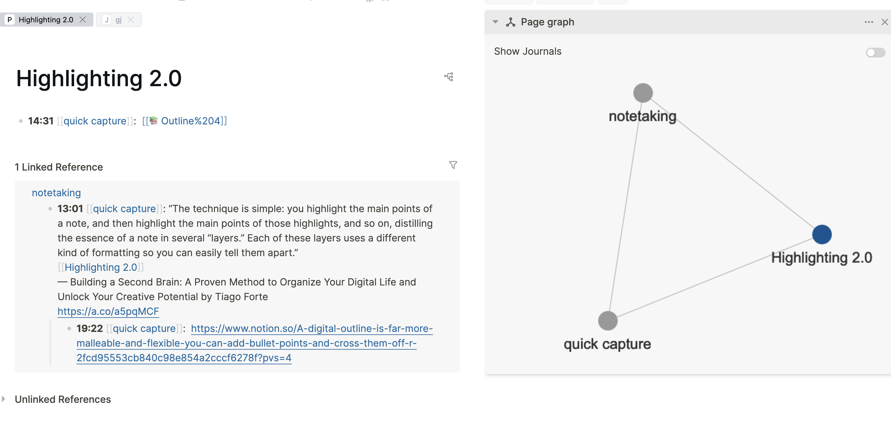

From the screenshot of page Highlighting 2.0, we can see:
1 Linked Reference, which is a backlink to page notetaking
Highlighting 2.0 is connected to page notetaking.quick capture (that is the [[quick capture]] literal)
Highlighting 2.0 is connected to page quick capture.
notetaking.You forgot the screenshot of page quick capture, where it should be:

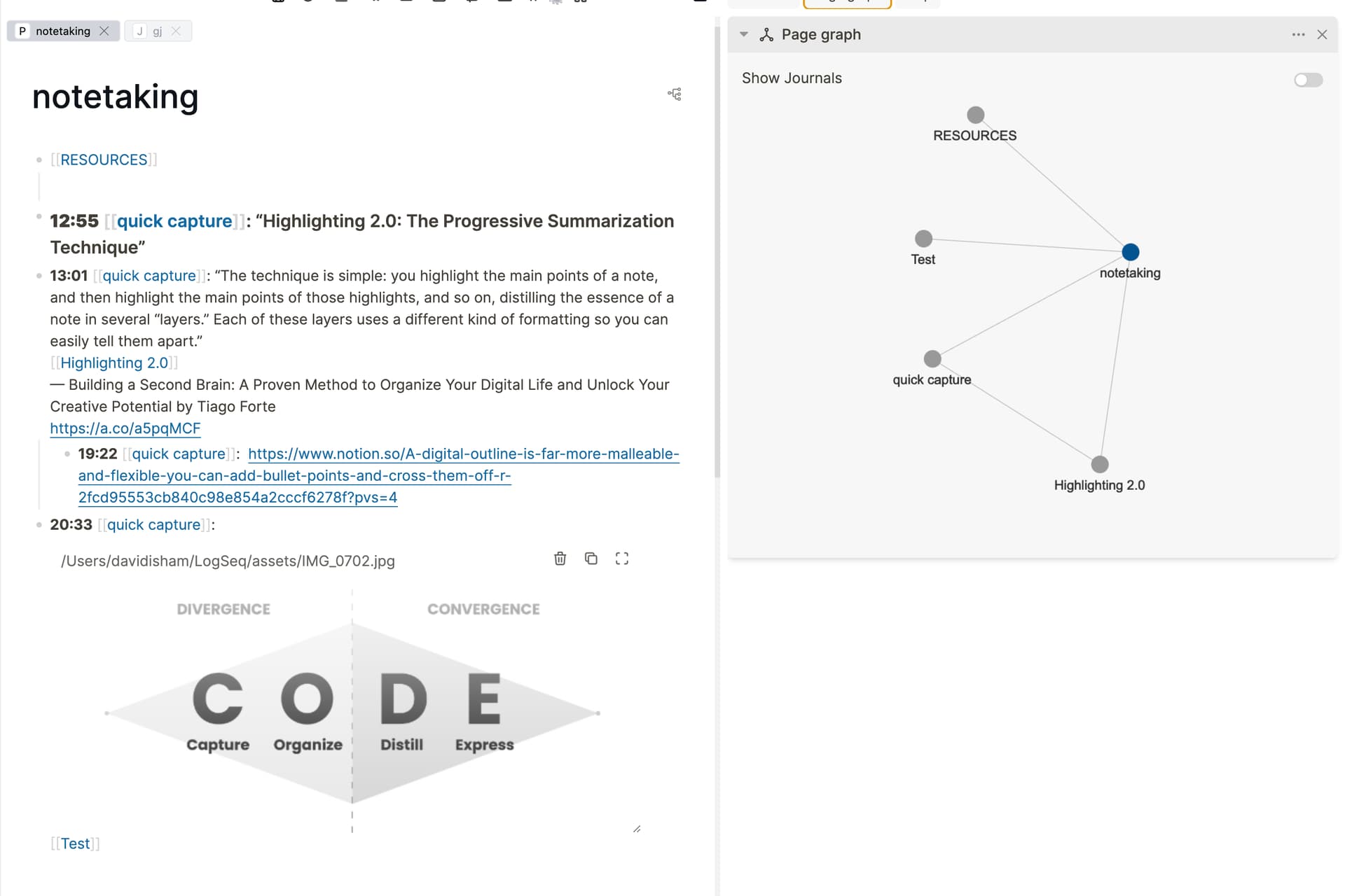

notetakingHighlighting 2.0Divergence_Convergence
Divergence_Convergence in the Graph view is not connected to page quick capture.
Divergence_Convergence seems missing from the current version of your graph, but we can make the same observation for any of the other pages (e.g. Test and RESOURCES), that they are:
notetaking
[[Test]] reference at the bottom of the pagequick captureWOW!! I finally got it.
