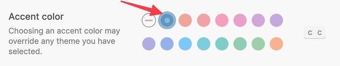

While this fixes the yellow color, the other default colors of white is gone. Like for tags and pages, it is showing color less.
Have you tried this accent color? Because that’s the original color (I agree it’s a bit confusing with the first option there that seems to indicate that’s the original color scheme):
That creates these color code blocks:
As you can see, the code block does not have a yellow background in the original color. The reason is that the UI has been tweaked over the past few releases and you probably had an old version of demo.logseq.com in your cache (I had that as well and the code block showed yellow until I cleared my cache and opened the demo graph again, and it shows exactly as in the screenshots I’ve just shared).
Anyway, selecting the second option from the accent color should bring you back to the original color scheme. You can then use mentaloid’s CSS snippet to solarize just the code blocks.
