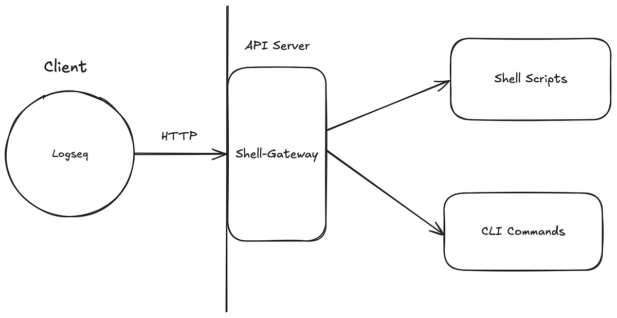

I faced a similar challenge recently when I needed to run some backend service. My solution was to create a workaround by setting up an API interface for the backend code. You can check out the details here:
