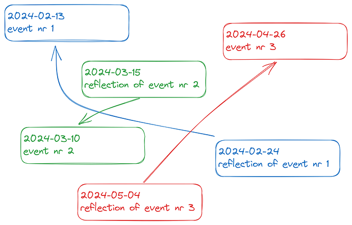

I have my journal pages where I write most of my stuff, but there are occasions when I write something on a different page and reference a specific journal date.
what I want is a query that returns journal pages between two dates, but also returns all the references to those dates.
Could you provide any examples of what (blocks, queries, most similar web findings that) you have so far?
edit:
here is what I mean explained with a graphic
pages:
what I want from the query:

//page "2024-02-13"
- event nr 1:
	- what is happening
	- what is planned
//page "2024-02-24"
- reflection of [event nr 1]([[2024-02-13]]):
	- what was good
	- what was bad

The primary issue is that you identify the events by their date. In contrast, the typical approach is to either:
  • use a block reference, i.e. ((block-id))
    • best for short events, like meetings
  • use a unique name for each event, then refer to them by page-references
    • even if you let those pages empty
    • examples:
      • [[event nr 1]]
        • It is important instead of - event nr 1: to use - [[event nr 1]]:
      • [[EURO 2024]]
        • An event that lasts more than one day.
      • [[2024/EURO]]
        • Namespaced version with easy auto-complete.
ok thanks a lot for the insight! deciding the best approach for current and future needs is such a daunting task.
