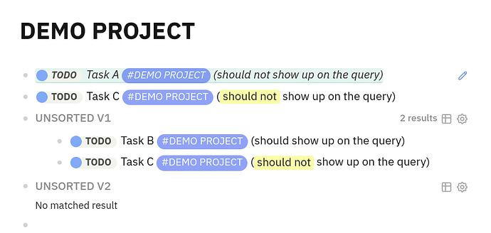

For context:
  • I have a page “DEMO PROJECT”
  • I have two blocks: “TODO Task A #[[DEMO PROJECT]” and “TODO Task B #[[DEMO PROJECT]]”
  • “TODO Task A #[[DEMO PROJECT]” is inline referenced in “DEMO PROJECT” while the other is not.
  • I want the query to show “TODO Task B #[[DEMO PROJECT]]”.
In other words, I need the query to show blocks with the following conditions:
  1. It has a TODO, DOING, or DONE and;
  2. It should have an inline tag #[[DEMO PROJECT]] and;
  3. It should not be inline referenced in the “DEMO PROJECT” page.

I tried the code but I get no matched result:
I tried to find which line of code gave trouble and here are the results:
  1. I isolated the code so that only conditions 1 and 2 will run and the query returned what I wanted.
  2. I isolated the code so that only conditions 1, 2, and 3 will run and the query gave “no matched results”.
  3. I isolated the code so that only conditions 1, 2, and 4 will run and the query gave “no matched results”.
The ‘test’ showed that there are likely problems with codes pertaining to condition 3 and 4 but idk why.
