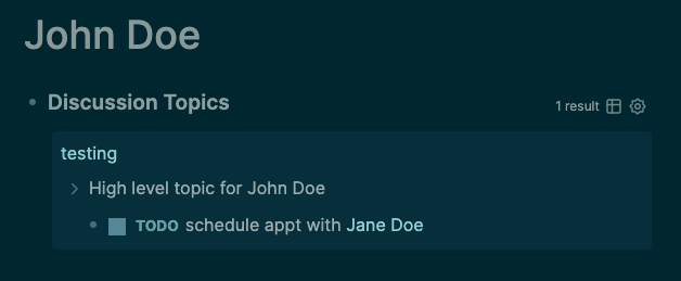

Here is the query I am using for both the John Doe and Jane Doe pages:
{:title [:h3 "Discussion Topics"]
 :query [
         :find (pull ?b [*])
         :in $ ?currentpage
         (page-ref ?b ?currentpage)
         (task ?b #{"NOW" "LATER" "TODO" "DOING"})
 :inputs [:current-page]}
For John Doe, it shows my TODO item for “Jane Doe”, even though “John Doe” is not in that TODO block. I am not sure why this happens other than to assume it’s being pulled from the parent block? I don’t know how to fix this.
For Jane Doe, the current query appears to work as expected, except I do not know how to also add in the block with the #discuss tag.
With all things remaining the same (besides the query of course) I want to get to where my “John Doe” page has nothing listed (I don’t have any discussion items for him) and my “Jane Doe” page has two items listed (the tagged item and the TODO item).
I think that (hopefully) gets you everything you need to know about what I am trying to do, and where I am currently at. Thanks for any assistance you may have for me!

Thanks for the help.
The parent may not be related at all to the actual block that I have flagged to discuss with someone. In fact, that is specifically the use case I am trying to address here.
So in your query, John Doe’s seems right, because there is nothing for him, but when I put it on the Jane Doe page, I get the parent bullet regarding John Doe, which does not belong here. It does get me the two discussion items for Jane tho, so this is definetely an improvement. However it also puts in any block that even mentions Jane Doe even if there is no TODO or #discuss tag.

I don’t know what the title of the query has to do with anything. Of course I am calling it Discussion Topics because that is the entire point of the query… to bring up the items I flagged for discussion. But that doesn’t have anything to do with the parent of the topics I flagged.
EDIT: Oh I see what is happening. My screenshot shows the result of the query… that’s why it says “Discussion Topics” in there. That’s the query title. The page that the result comes from is “testing.”
Regardless, this version seems to work! (with one exception)
My original query only showed opened tasks, but your version doesn’t clear them when they are checked. How do I incorporate this into your version? (task ?b #{“NOW” “LATER” “TODO” “DOING”})

This is possible by adding :breadcrumb-show? false below the :inputs line.
