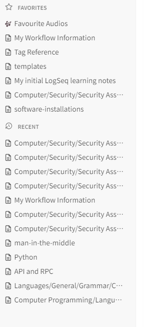

Just a quick screenshot showing my (mostly self inflicted) pain :slight_smile:
All of these do have an alias:: configured.
