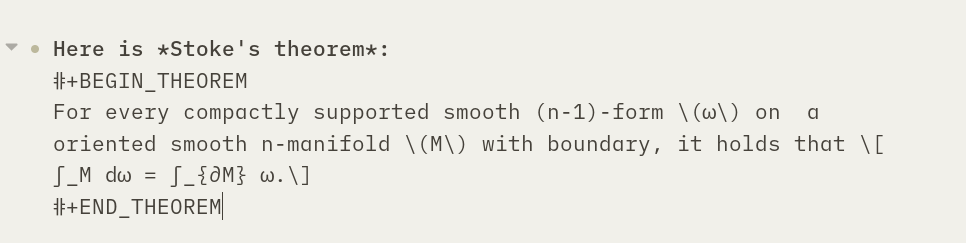

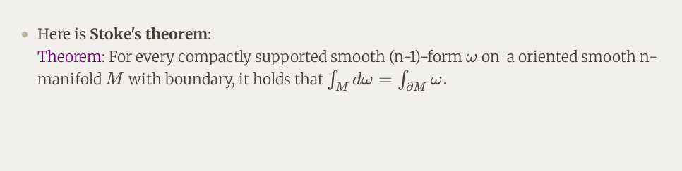

I have come up with the following solution. I found that whichever #+BEGIN_ARBITRARYNAME environment gets parsed as a div.arbitraryname element, therefore one can use modify it via custom.css.
In the following example before the contents of the environment THEOREM the purple colored label “Theorem: ” is put.
/*custom.css*/
div.theorem > div.is-paragraph::before {
    content: "Theorem: ";
    color: purple;
Here is *Stoke's theorem*:
#+BEGIN_THEOREM
For every compactly supported smooth (n-1)-form \(ω\) on  a oriented smooth n-manifold \(M\) with boundary, it holds that \[ ∫_M dω = ∫_{∂M} ω. \]
#+END_THEOREM
Remark: #+BEGIN_FOO, #+begin_foo, #+BEGIN_foo etc. all get turned into div.foo.
