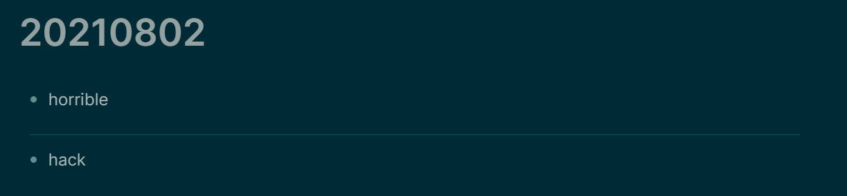

if you’re only looking for a cleaner look, this horrible hack might do the trick:
hr {
margin: -0.25rem -1.1rem;
border-top: 20px solid var(--ls-primary-background-color);
border-bottom: 1px solid var(--ls-border-color);
it basically hides the bullet under a fat border… ¯\_( ಠ_ಠ )_/¯
