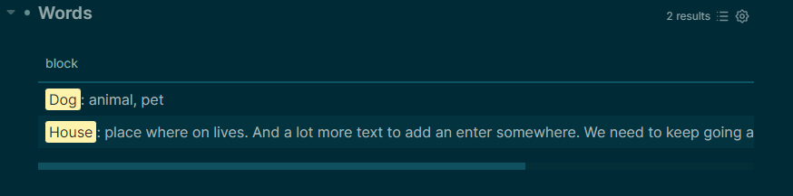

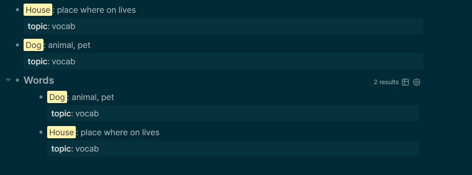

which gives me a list of words, like so:
==House==: place where on lives
==Dog==: animal, pet
Is it possible to sort the list alphabetically on the basis of the 1st word in each phrase?
So, the list would look like this:
Do you mean to sort by Dog and House?
Then you just need to sort by block content.
{:title [:h3 "Words"]
   [?b :block/properties ?prop]
   [(get ?prop :topic) ?topic]
   [(= ?topic "vocab")]
 :result-transform (fn [result] (sort-by (fn [r] (get r :block/content)) result))
 :remove-block-children? false
Yep, that is exactly what I was looking for. Many thanks for that.

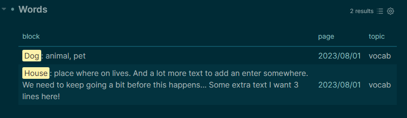

Last question in this context:
block and topic are vertically aligned with the text below them, but page is not, which is odd. Can vertical alignment be done for page, or is it a Logseq quirk?
Quirk of your theme actually. Default Logseq result tables don’t break lines apparently :open_mouth:
I don’t know about your theme, but I use some custom css in my personal graph
table th,
table td {
	white-space: normal !important;
	overflow-wrap: normal;
	word-break: normal;
It will then look like this:
Thanks. It is not a quirk, but this in my custom.css:
table td:nth-child(2) {
  text-align: center;
table th:nth-child(2) {
  text-align: center;
which I had because text in “regular” tables was only centered in some columns.
When I disabled this snippet the page header was aligned again. I still find it odd that only the page header was out of kilter, but that is not important.
What counts is the solution, and you provided it.
