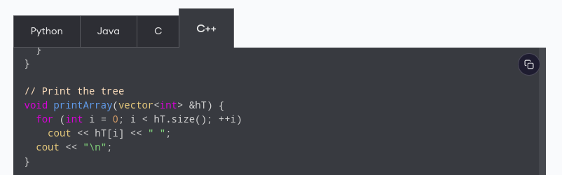

As a developer I use different programming language to write code. It will be very helpful to have query that will put multiple pages/blocks in tabs
Tiddlywiki provide that feature using
<<tabs "SampleTabOne SampleTabTwo SampleTabThree SampleTabFour" "SampleTabOne" "$:/state/tab1">>
Does anyone know how to add tabs on pages ? ( like query on properties adds table view )

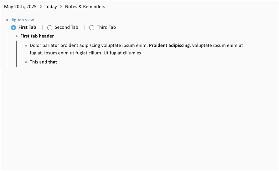

Thanks so much for this. This is really elegant as a solution!

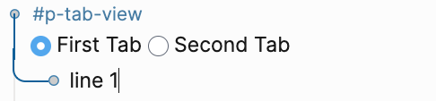

Hi I can use this modification to insert a tab inside a page, however I am unable to add multiple lines / blocks under each tab:
After pressing enter, the caret disappears and I cannot add new line / block (I actually cannot type anything on the page)
The steps that I implemented are the following:
  1. I pasted the following code snipped to the custom.css file:
div[data-refs-self*="p-tab-view"] .block-children .ls-block {
  display: none;
div[data-refs-self*="p-tab-view"]:has(input[value="1"]:checked) .block-children .ls-block:nth-of-type(1) {
  display: block;
div[data-refs-self*="p-tab-view"]:has(input[value="2"]:checked) .block-children .ls-block:nth-of-type(2) {
  display: block;
  1. Then I added the following code snipped to the daily journal page:
#p-tab-view
[:span [:input {:type "radio" :name "ptv" :id "1" :value "1" :checked true}[:label {:for "1"} " First Tab "]] [:input {:type "radio" :id "2" :name "ptv" :value "2"}[:label {:for "2"} " Second Tab "]]]
Any help appreciated, thanks!

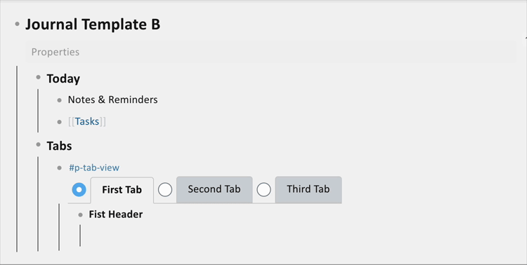

Try pasting this into your custom.css file:
    RADIO BUTTON TAB GROUP - v2025.05.24
    - Author:     <https://github.com/zeitlings>
    - Reference:  <https://discuss.logseq.com/t/tabs-inside-pages/12952>
  display: none;
div[data-refs-self*="p-tab-view"]:has(input[value="1"]:checked) .block-children .ls-block:nth-of-type(1),
div[data-refs-self*="p-tab-view"]:has(input[value="1"]:checked) .block-children .ls-block:nth-of-type(1) .ls-block {
  display: block;
div[data-refs-self*="p-tab-view"]:has(input[value="2"]:checked) .block-children .ls-block:nth-of-type(2),
div[data-refs-self*="p-tab-view"]:has(input[value="2"]:checked) .block-children .ls-block:nth-of-type(2) .ls-block {
  display: block;
div[data-refs-self*="p-tab-view"]:has(input[value="3"]:checked) .block-children .ls-block:nth-of-type(3),
div[data-refs-self*="p-tab-view"]:has(input[value="3"]:checked) .block-children .ls-block:nth-of-type(3) .ls-block {
  display: block;
div[data-refs-self*="p-tab-view"]:has(input[value="4"]:checked) .block-children .ls-block:nth-of-type(4),
div[data-refs-self*="p-tab-view"]:has(input[value="4"]:checked) .block-children .ls-block:nth-of-type(4) .ls-block {
  display: block;
div[data-refs-self*="p-tab-view"]:has(input[value="5"]:checked) .block-children .ls-block:nth-of-type(5),
div[data-refs-self*="p-tab-view"]:has(input[value="5"]:checked) .block-children .ls-block:nth-of-type(5) .ls-block {
  display: block;
div[data-refs-self*="p-tab-view"]:has(input[value="6"]:checked) .block-children .ls-block:nth-of-type(6),
div[data-refs-self*="p-tab-view"]:has(input[value="6"]:checked) .block-children .ls-block:nth-of-type(6) .ls-block {
  display: block;
/* Tab Group styling */
input[type="radio"][name="ptv"] {
  opacity: 100%;
  width: 15pt;
  height: 15pt;
  margin-right: 6px;
  margin-left: 6px;
  /* color: var(--ls-active-secondary-color); */
input[type="radio"][name="ptv"] + label {
  display: inline-flex;
  padding: 6px 12px;
  margin: 0;
  border: 1px solid var(--ls-border-color);
  background-color: var(--ls-tertiary-background-color);
  color: var(--ls-primary-text-color);
  cursor: pointer;
  transition: all 0.2s ease;
  border-radius: 4px 4px 0 0;
  border-bottom: none;
  position: relative;
  top: 1px;
  user-select: contain;
  border-bottom: 1px solid var(--ls-border-color);
  top: 0;
input[type="radio"][name="ptv"]:checked + label {
    background-color: var(--ls-primary-background-color);
    border-bottom: 1px solid var(--ls-primary-background-color);
    top: 1px;
    font-weight: bold;
input[type="radio"][name="ptv"] + label:hover {
  background-color: var(--ls-secondary-background-color);
span:has(input[name="ptv"]) {
  display: inline-block;
  padding-bottom: 0;
    RADIO BUTTON TAB GROUP END
That supports up to to 6 tabs. To enable more tabs, just add more of these:
div[data-refs-self*="p-tab-view"]:has(input[value="7"]:checked) .block-children .ls-block:nth-of-type(7),
div[data-refs-self*="p-tab-view"]:has(input[value="7"]:checked) .block-children .ls-block:nth-of-type(7) .ls-block {
  display: block;
etc.
And in your journal template, try this:
- ## Tabs
	- #p-tab-view
	  [:span [:input {:type "radio" :name "ptv" :id "1" :value "1" :checked true}[:label {:for "1"} " First Tab "]] [:input {:type "radio" :id "2" :name "ptv" :value "2"}[:label {:for "2"} " Second Tab "]] [:input {:type "radio" :name "ptv" :id "3" :value "3"}[:label {:for "3"} " Third Tab "]]]
		- **Fist Header**
		- **Second Header**
		- **Third Header**
You have to pre-populate what comes after the declaration with correlating headers and one empty child bullet, then you can edit directly within each self contained tab. For more tabs, again just extend the hiccup and add the fourth, fifth, etc. header.
