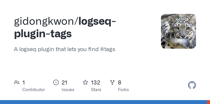

Give this plugin a try:
This looks useful, I’ll look into it. Thanks.
