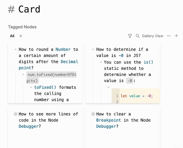

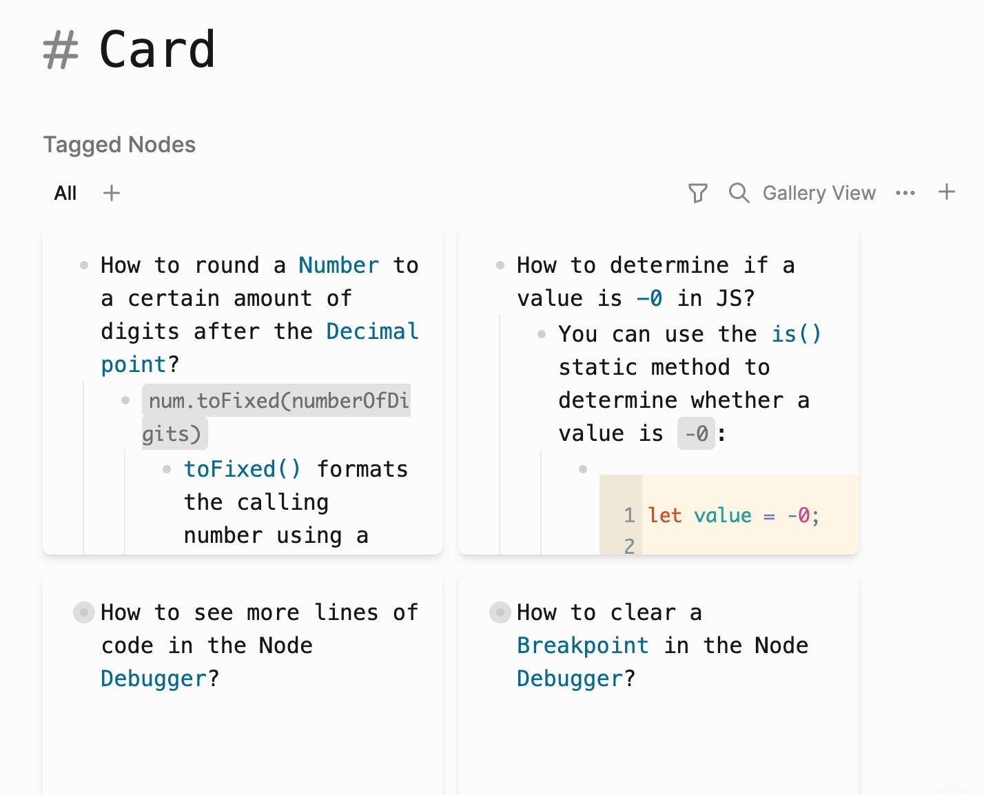

The Flashcards feature uses an algorithm (SM5 in Logseq Org/MD, replaced by FSRS in Logseq DB). These algorithms are designed to serve the flashcards towards the end of the forgetting curve, so you don’t waste time cramming stuff you weren’t likely to forget anyway.
If you do want to cram, I recommend writing a regular query. Then you can just test yourself by collapsing all the child blocks and expanding each individually to check your answer.

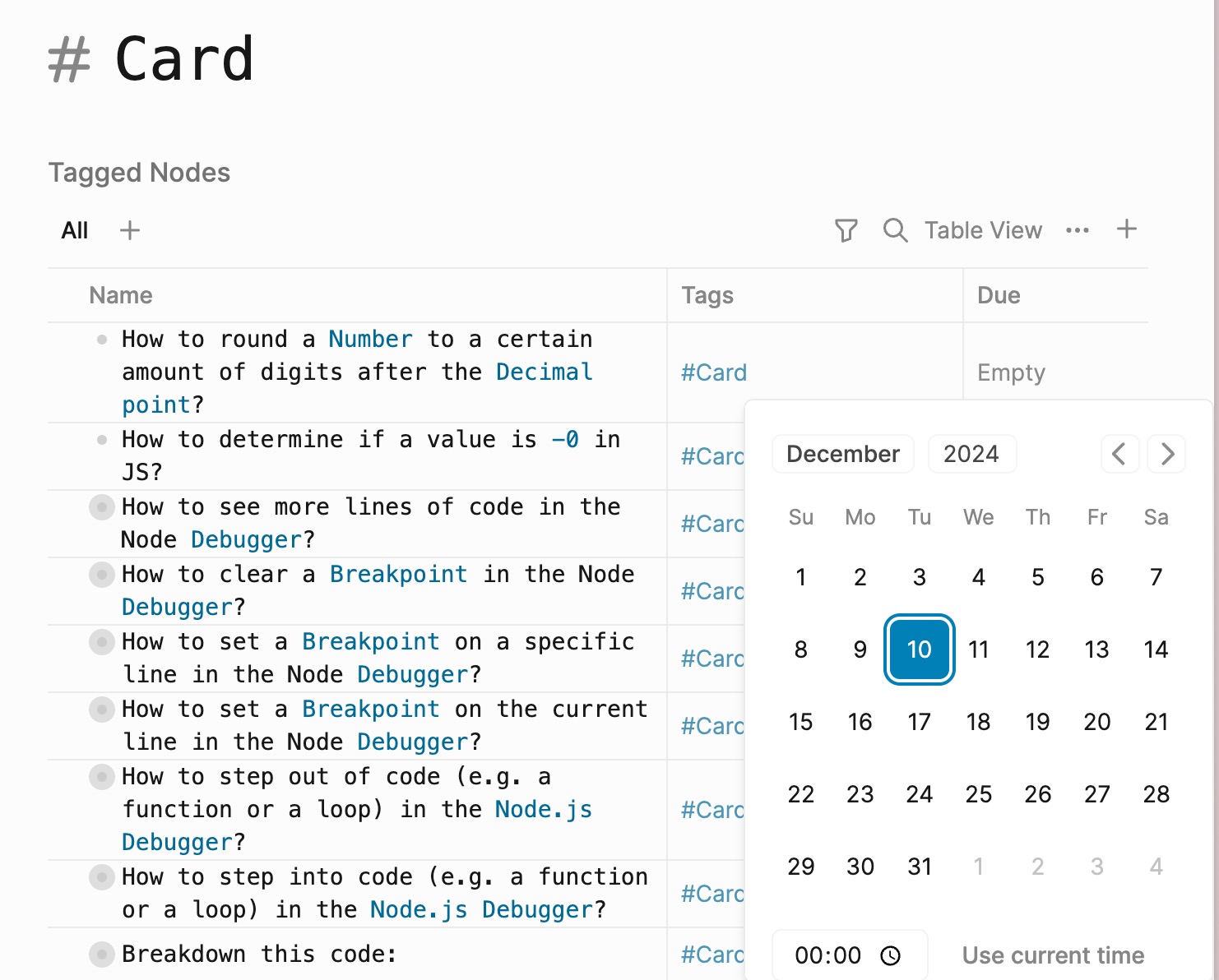

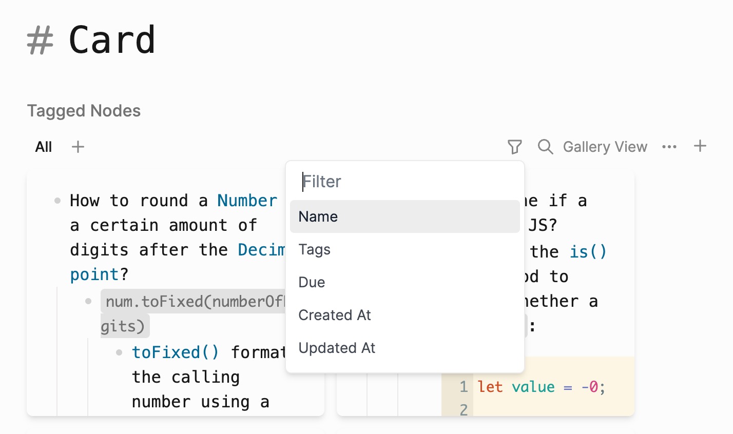

In Logseq DB, the #card page has some tools to show and filter your flashcards which could save you writing a query. It even gives easy access to the Due property and lets you change it:
