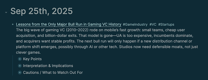

I real quite much blogs and books and I log into logseq summaries with tags and so on.
Every now and then I want to read a random one, just to go back to sthg I read some time ago and revisit it, think about it again, etc. I love this process of revisiting things we liked in the past.
This is a real example of a log. I have hundreds of this and I would like to have a way of viewing one randomly
I don’t really know how to do this, but one option would be to put some #tags and after that the code gets you one random
