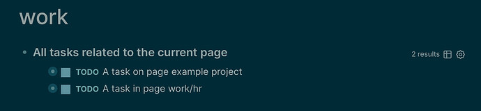

So I eh… reconsidered that entire query, as I was trying to adjust it to add the properties criteria.
If you place this query on the work page (or any other page for that matter). It’ll get all tasks related to the page the query is on.
You can change the input to any lower case page name to get tasks for that specific page, while the query is elsewhere.
Let me know how it goes!

You are amazing, thank you.
I’m really sorry for my ignorance, but how should I modify the query if I want to retrieve tasks from another page? Where should I type the name of the page (in my example: work) I am requesting?
Change this part to: :inputs ["work"]
Or place the query on the page work if you prefer. (As seen in my screenshot)
And don’t worry about it :slight_smile: we all need to learn things the first time.
